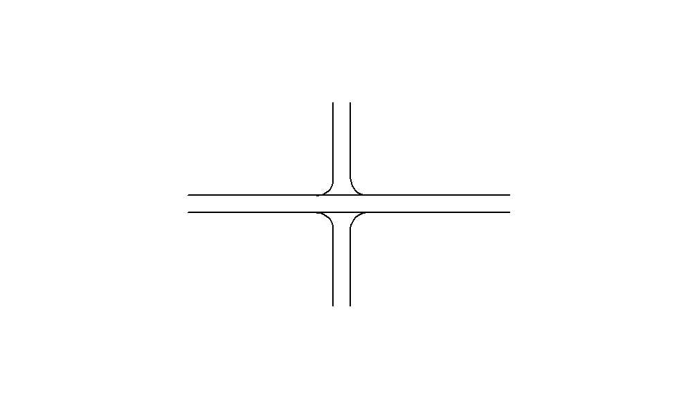

Steve, Just a suggestion here, but if you try this on your next one, I'd leave one of your x-braces.....well, as an example only, let's say your braces are .250" wide. If you left one about .75" wide within say .25" of either side of the intersection, then carve the fillets once the X is glued, I would think the joint would be even stronger with that much gluing surface!
DES - Farwell, MI
PostPosted: Sat Jan 13, 2007 3:53 pm
Posts: 329
Here's what I mean (no, I didn't take this long to draw it! ).
DES - Farwell, MI

One problem with that setup, Darin, is that you're still gluing end grain to side grain, and the joint will have little or no strength in tension unless it is fitted very well and glued with epoxy. Even then.
In fact, the whole idea of fillets seems less and less good to me the more I think about it. The only way to avoid having some end grain joints would be to make the fillet pieces run across the grain of the braces, and then they will not be nearly as strong in tension as the wood they're glued to. By comparison, the 'patch' over the open side of the box joint can be as strong as you want to make it, with little, if any, added weight, and it is simple to do. Why make things more complicated _and_ less strong?

Ya, I see what you're saying. K.I.S.S.! Plus, how tedius would it be to carve the fillets from the brace itself?    However, I think Steve's original idea of fillet pieces, with the end grain facing the top to provide a better gluing surface toward the brace could help the joint. The question remains, "Is it worth the time making those little piece for possibly a minimal gain?" I like the idea nonetheless, Steve!
